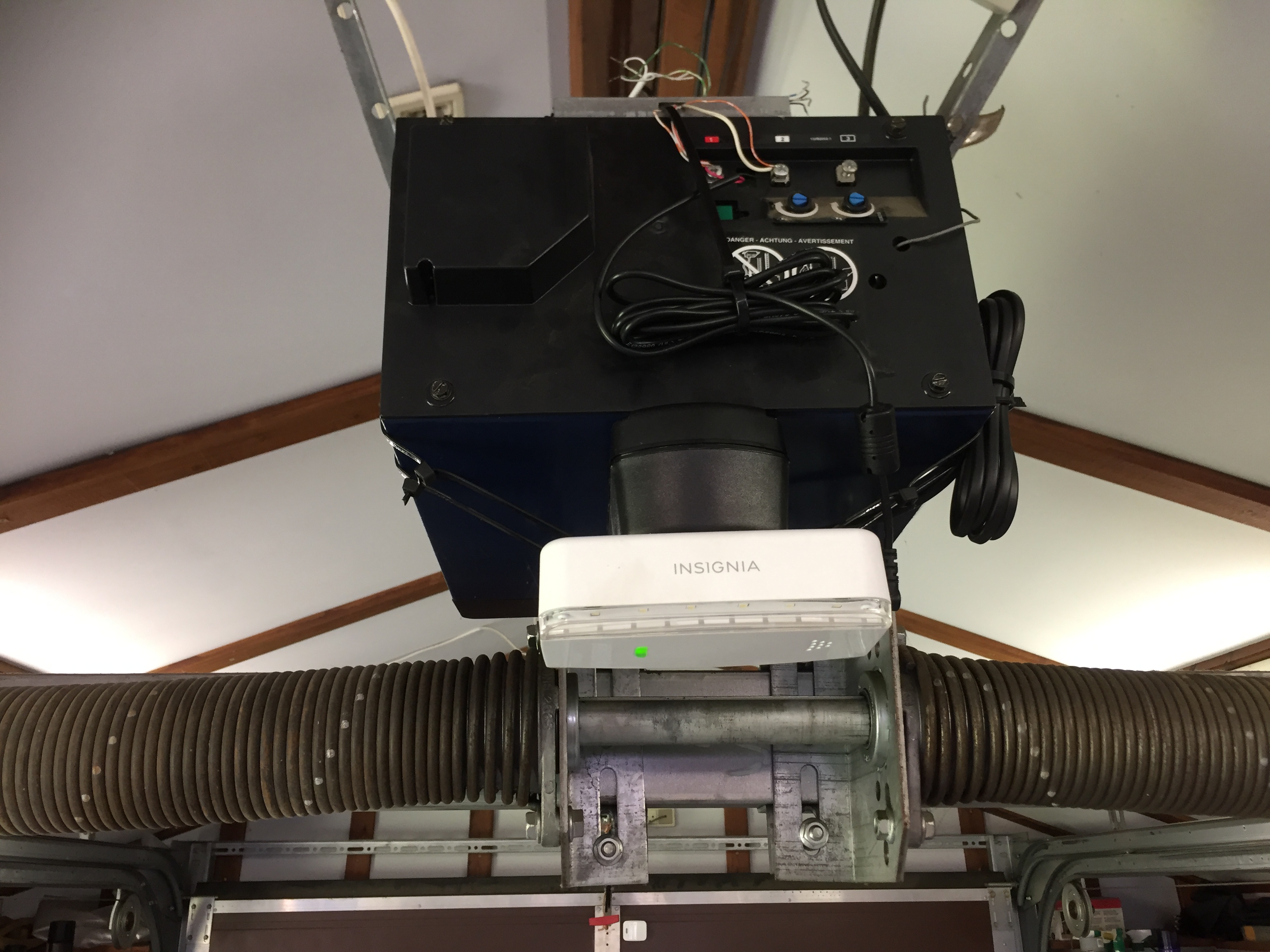

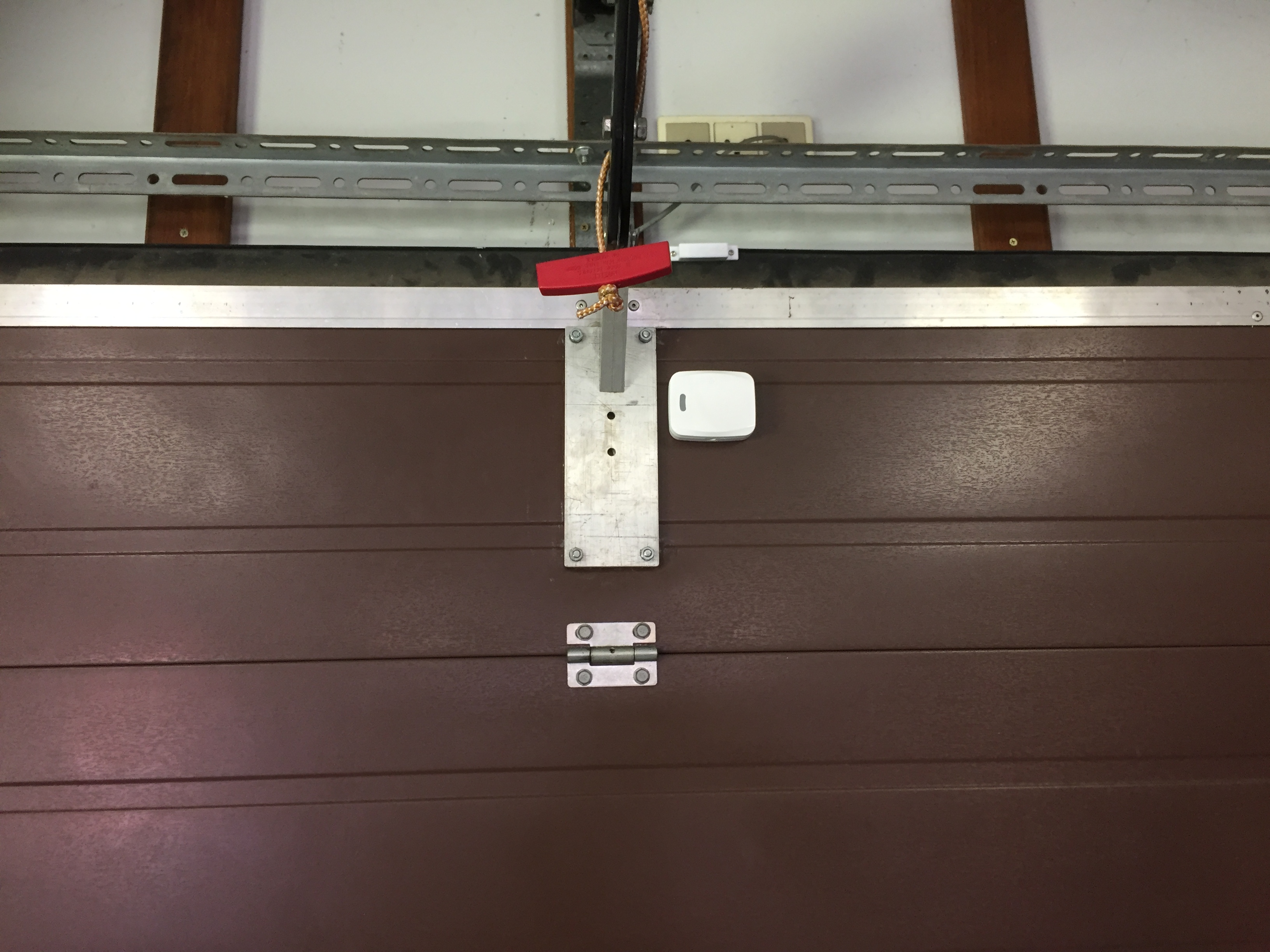

I got my Insignia Garage mounted in place and wireless sensor on the gate itself. Insignia is Homekit compatible.
There is a 110V converter because the Insignia from the US uses 110V.

That is it,
Works like Sonoff garage door with pulse to relay. It has position sensor wireless.
